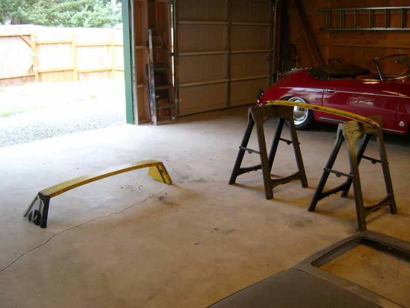

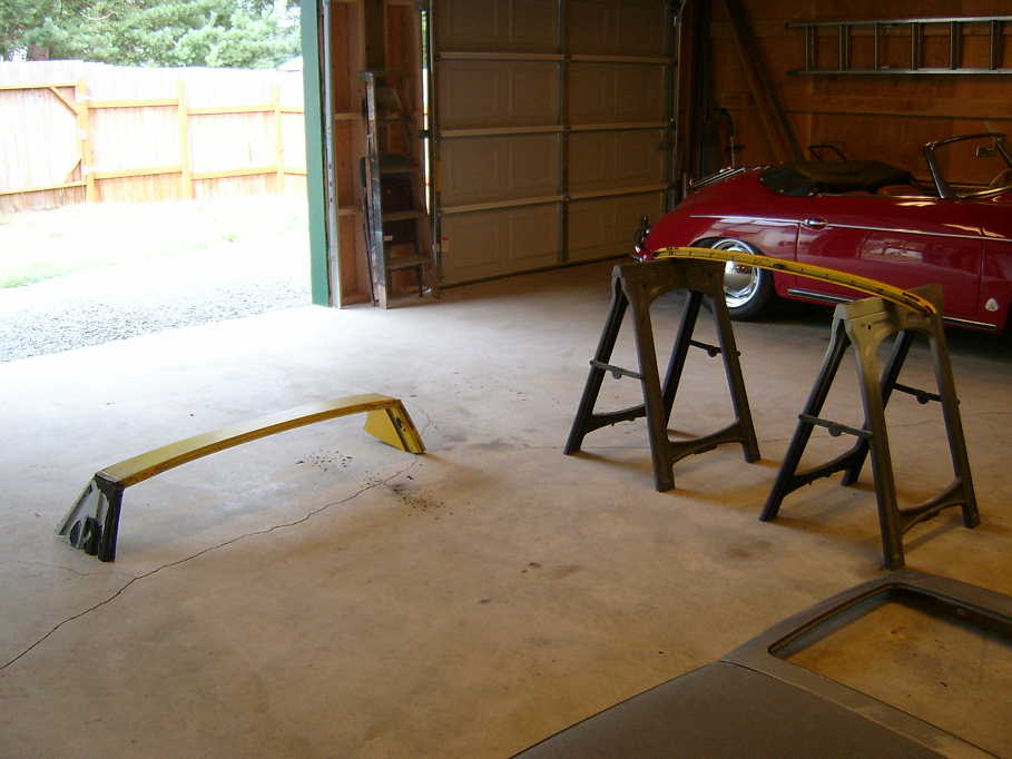

Here are those saw horses with the donor 914 top parts ready to be used as jigs and even welded onto the 944 roof section, well, parts of the donor parts anyway.
