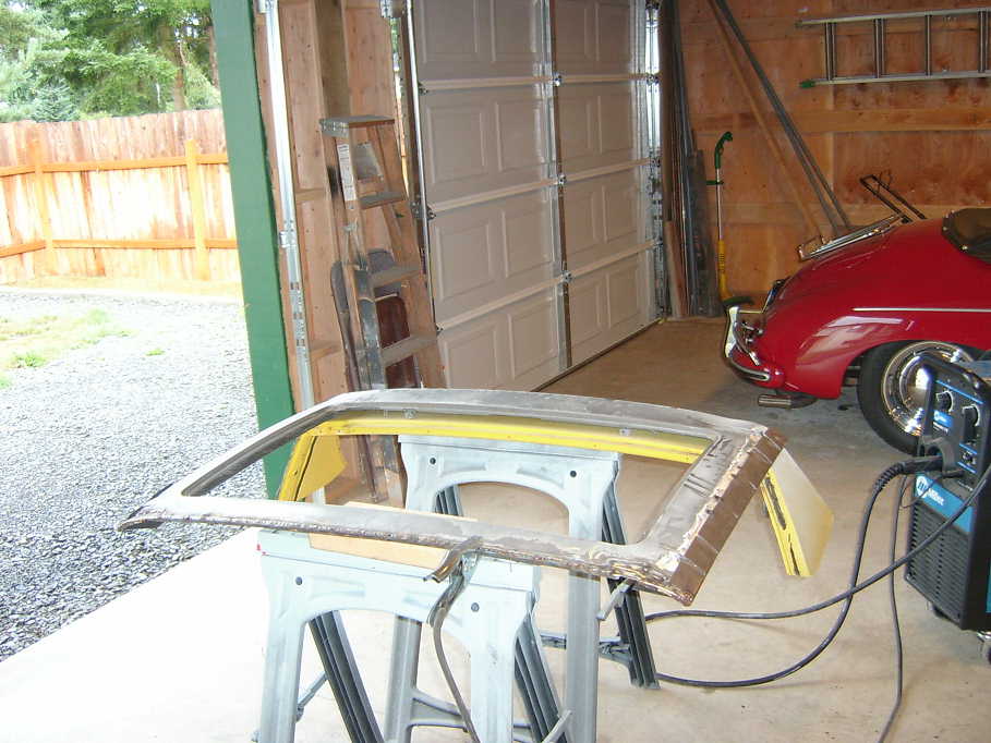

Member No.: 2,105
First trial of my side extensions. I didn't get any shots of the actual making or tooling of them, here they are lightly tac'd into place and set on the rear targa bar to check the fit and curve. These were the hardest parts because they have a radious that has to follow the top of the door window along with the curve that has to follow the top down to the sides AND still have a finished edge with NO body filler. Like I said before, yuck. (IMG:style_emoticons/default/welder.gif)

Root_Werks   First trial of my side extensions. I didn't g...   Sep 17 2007, 10:56 PM
