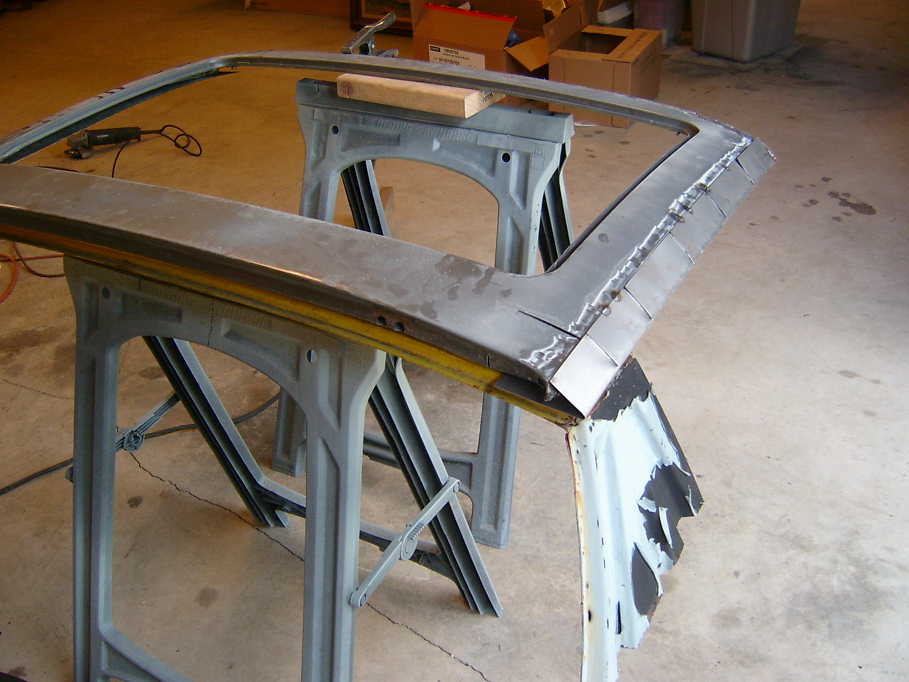

This is not a project for any sort of beginer or not anything I would recomend for anyone who cannot do it all themselves. I spent waaaaay too many hours to justify having an actual shop try it. I also probably wouldn't ever do this again for fear that I wouldn't be able to reproduce the same results. Yeah, it turned out that good. That said, as I post pictures, understand this project is already DONE. So it WORKS and looks as though the factory installed every piece. So sit back, enjoy and maybe dream that you might one day yourself embark on such a task. Hopefully this will help those few people who dare to be as stupid as I. (IMG:style_emoticons/default/screwy.gif)

More welding, more checking, pretty rough, but starting to come together, sort of. At this point, I was still thinking I was going to just toss the whole thing in the trash. Figured it was fun trying, but the back section just wasn't turning out like I hoped. This photo is still a LOOOOOOOONG way from fitting to any car.
