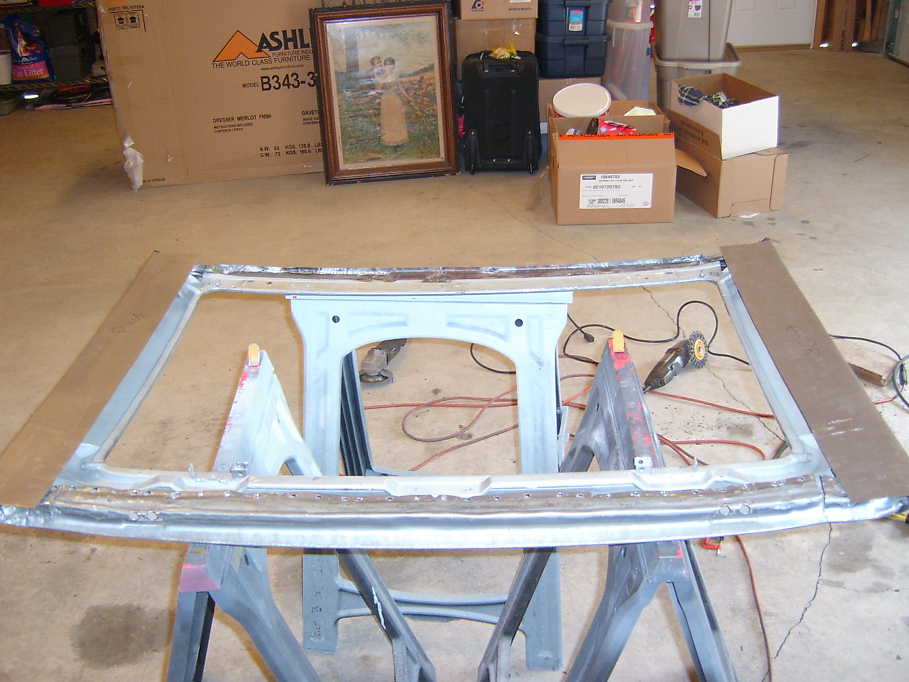

This is not a project for any sort of beginer or not anything I would recomend for anyone who cannot do it all themselves. I spent waaaaay too many hours to justify having an actual shop try it. I also probably wouldn't ever do this again for fear that I wouldn't be able to reproduce the same results. Yeah, it turned out that good. That said, as I post pictures, understand this project is already DONE. So it WORKS and looks as though the factory installed every piece. So sit back, enjoy and maybe dream that you might one day yourself embark on such a task. Hopefully this will help those few people who dare to be as stupid as I. (IMG:style_emoticons/default/screwy.gif)

Bottom view, note the two flat surfaces. This is what I would mounting the window seal chanels to. They also get formed into a "box" that gets welded to the targa bar and windshield frame. Mucho strenth added because of that for sure.

Spoke   Is the 914 windshield hoop any weaker or stronger ...   Sep 17 2007, 08:43 PM
Root_Werks   Is the 914 windshield hoop any weaker or stronger...   Sep 17 2007, 10:36 PM

scotty b   FYI for anyone contemplating this. Make certain th...   Sep 18 2007, 08:29 PM
Root_Werks   B)-->
QUOTE(scotty b @ S...   Sep 18 2007, 08:34 PM
