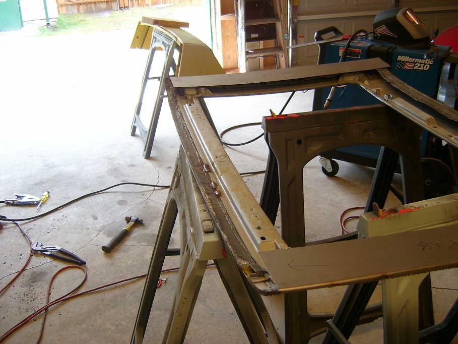

This is not a project for any sort of beginer or not anything I would recomend for anyone who cannot do it all themselves. I spent waaaaay too many hours to justify having an actual shop try it. I also probably wouldn't ever do this again for fear that I wouldn't be able to reproduce the same results. Yeah, it turned out that good. That said, as I post pictures, understand this project is already DONE. So it WORKS and looks as though the factory installed every piece. So sit back, enjoy and maybe dream that you might one day yourself embark on such a task. Hopefully this will help those few people who dare to be as stupid as I. (IMG:style_emoticons/default/screwy.gif)

Last picture for tonight, getting tired. I wish I would have taken better pictures of this one. I wound up cutting the very top front of the donor windshield and grafting it onto the 944 roof section to get an exact curve match to my 914 frame. After carefully cutting and cutting I wound up leaving a 2 layer piece together which had a lot of strength to it. This ensured my welding the arc to the front of the 944 roof section would match spot on to my 914 winshield frame. Lots and lots of welding after this, folding down the "boxes" and welding them to the 944 roof section. At this point, I could set the top on my 914 and it looked just like the fiberglass top. Sat on there exactly the same. Next photos I start welding on my car! Doh! (IMG:style_emoticons/default/w00t.gif)

Root_Werks   First trial of my side extensions. I didn't g...   Sep 17 2007, 10:56 PM
Root_Werks   More welding, more checking, pretty rough, but sta...   Sep 17 2007, 11:00 PM
