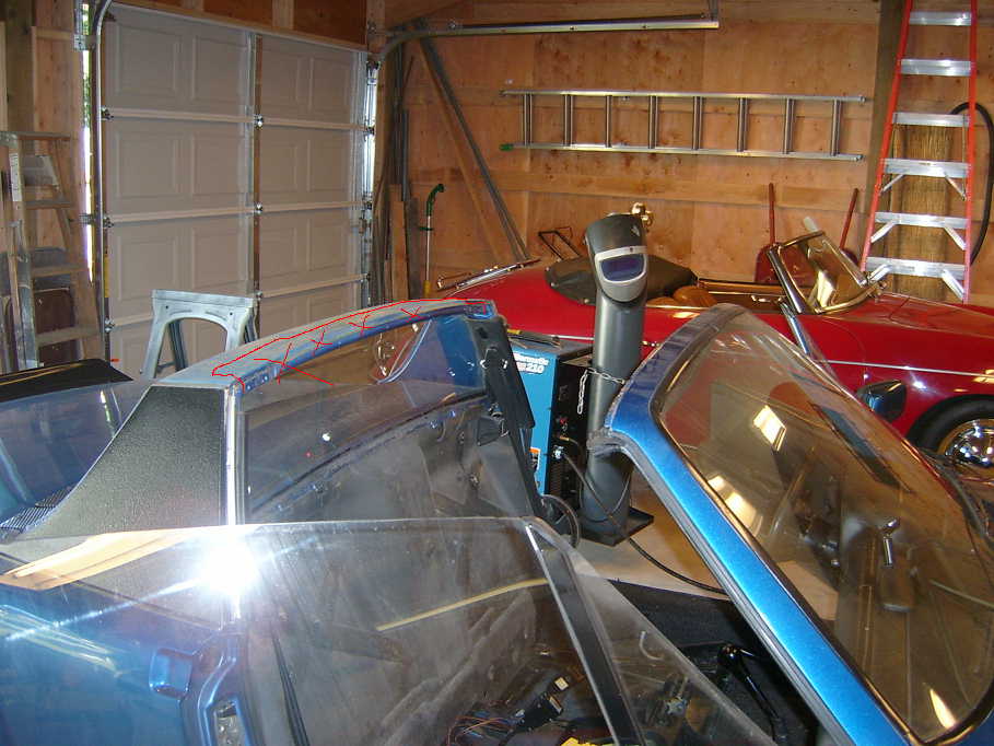

Still thinking to myself; "I can still turn back, just put it all back together" My ultra exact red lines indicate what I had to remove from the rear targa bar to have the sunroof fit correctly. (IMG:style_emoticons/default/sawzall-smiley.gif)
