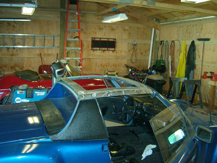

I can still just put everything back.....
Notice I cut off the back because I just wasn't happy with the ends or corners. I welded up metal, ground, welded, cut off, re welded, new metal, ugh, finally cut it all off and decided I just couldn't manufature that back finished piece. Having the back open for the attatchment made it perfect for welding the top to what was left of the roll bar and my added support bar.
I can still put everything back and just walk away.....

Root_Werks   Still thinking to myself; "I can still turn b...   Sep 18 2007, 08:17 PM
Root_Werks   I can still just put everything back..... Notice ...   Sep 18 2007, 08:22 PM
sww914   Nice sawhorses! I think you ran out and bought...   Sep 18 2007, 08:27 PM
Root_Werks   No turning back now, rear targa bar cut, first wel...   Sep 18 2007, 08:28 PM

Root_Werks   My special bar to reinforce what I cut off of the ...   Sep 18 2007, 08:31 PM
Root_Werks   Fast forwarding since this is not a "how to...   Sep 18 2007, 08:41 PM
Root_Werks   Actually one more for tonight. I wound up cutting...   Sep 18 2007, 08:49 PM
