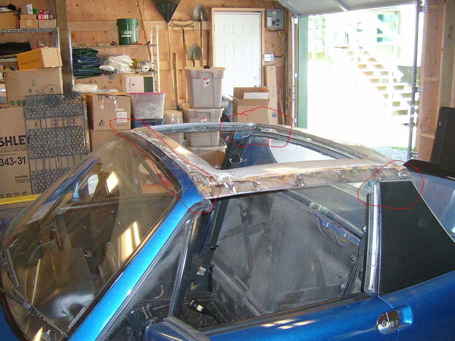

No turning back now, rear targa bar cut, first welds done to secure the top to the car. Holy crap, what have I done? (IMG:style_emoticons/default/blink.gif)

Root_Werks   No turning back now, rear targa bar cut, first wel...   Sep 18 2007, 08:28 PM
scotty b   FYI for anyone contemplating this. Make certain th...   Sep 18 2007, 08:29 PM
