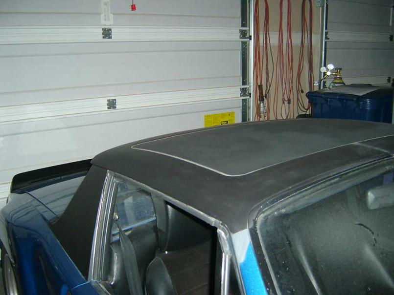

This is not a project for any sort of beginer or not anything I would recomend for anyone who cannot do it all themselves. I spent waaaaay too many hours to justify having an actual shop try it. I also probably wouldn't ever do this again for fear that I wouldn't be able to reproduce the same results. Yeah, it turned out that good. That said, as I post pictures, understand this project is already DONE. So it WORKS and looks as though the factory installed every piece. So sit back, enjoy and maybe dream that you might one day yourself embark on such a task. Hopefully this will help those few people who dare to be as stupid as I. (IMG:style_emoticons/default/screwy.gif)

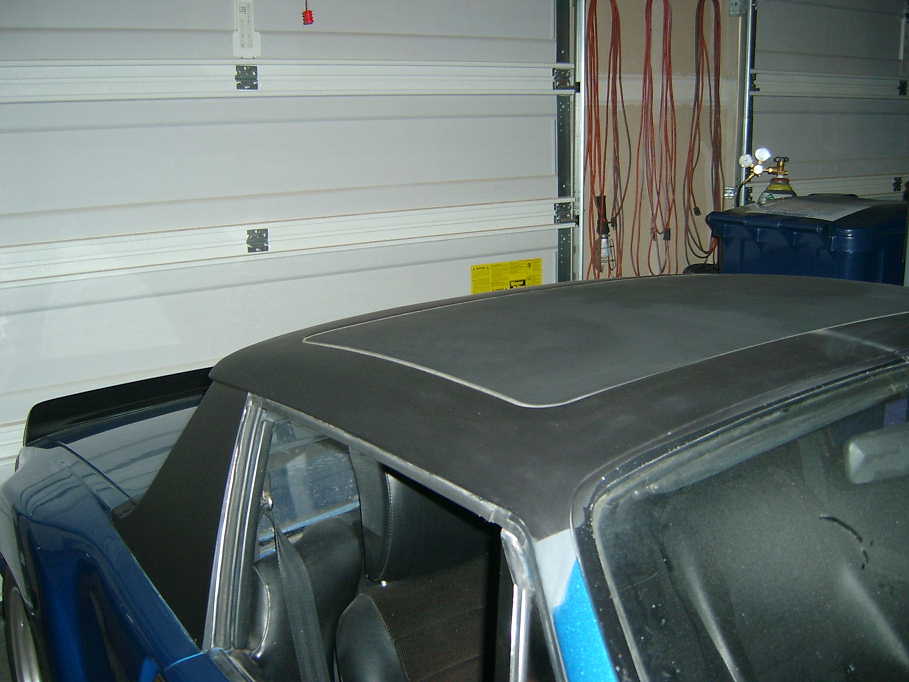

Fast forwarding since this is not a "how to" thread, just an "I did it so maybe you can to". Almost ready for paint in this photo, just a little more flat boarding and touch up.
Also, if you heli-arc the factory chanels together, you can buy the nice new universal style window seals so they will be all one piece for around $2 a foot. Pretty cheap, seal up perfect, look totaly stock blah, blah. There you go folks. I'll post some more painted pictures later on maybe. It can be done. Completely changes the car, tight and quiet now. I dare say almost like a normal car?
