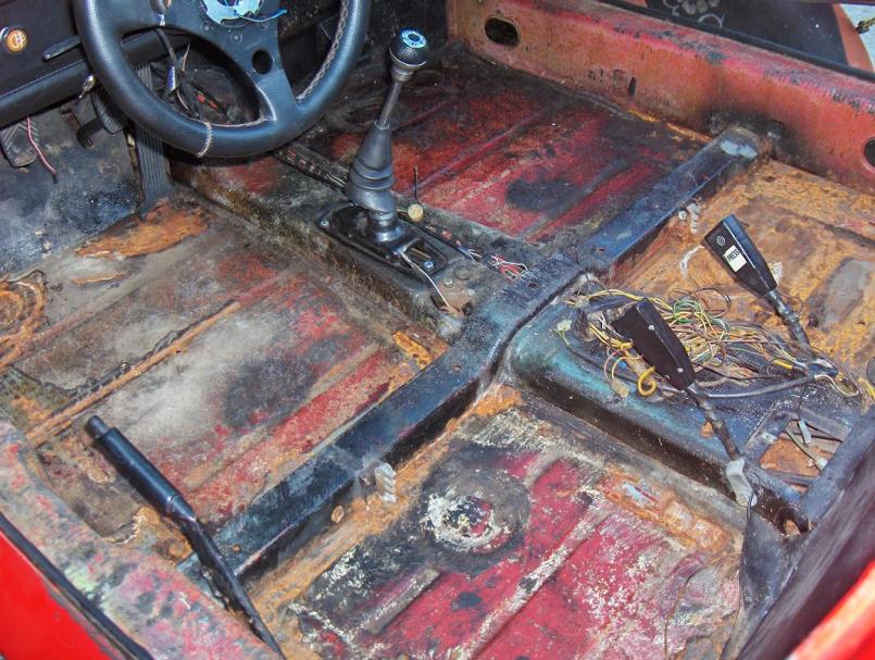

so i decided to just.. "dig in"! here's where i stopped for the day
I found $0.12, the broken handle for the seat adjustment, and one of the screw things for the headlight motor!!! woohoo

type47   is it rusted through, that is, do you see the road...   Sep 23 2007, 02:18 PM
stateofidleness   Now I've pretty much read EVERY thread in the ...   Sep 23 2007, 02:21 PM
stateofidleness   Type, it is rusted through in SOME spots but not a...   Sep 23 2007, 02:25 PM
Blood red 914-6gt   I have a new rear pan with the stiffeners that I t...   Sep 23 2007, 02:57 PM
Bartlett 914   That all looks repairable. I would look over the l...   Sep 23 2007, 03:02 PM
Chuck   Don't worry. You can do this. At least your se...   Sep 23 2007, 03:39 PM

swl   You'll have to change your handle if your are ...   Sep 23 2007, 07:23 PM
swl   heck - that ain't rust! You're good t...   Sep 23 2007, 07:26 PM

Brett W   Peel up all of the tar crap in the floor boards an...   Sep 23 2007, 07:38 PM

Bartlett 914   You have a couple of holes to patch up. Not too ba...   Sep 24 2007, 08:06 AM

stateofidleness   it actually looks patchable right now. how do i t...   Sep 26 2007, 05:24 PM
SirAndy   do a search here. McMark posted some good pics of ...   Sep 26 2007, 05:31 PM
flipity   I wish my car was in that condition! My floor...   Sep 26 2007, 05:34 PM

McMark   Lots more cleaning to do. Grab some rust converte...   Sep 26 2007, 06:49 PM
stateofidleness   i was wondering about that.. the order of events i...   Sep 26 2007, 07:21 PM
McMark   Rust converters such as POR-15 MetalReady can be u...   Sep 26 2007, 07:31 PM
