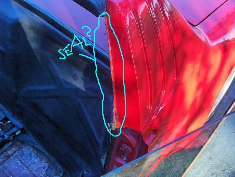

...and this one is a little OT but just throwing it out there in case anyone has one on a roller or parts car that they dont need:

stateofidleness   how is that back pad affixed to at the top? i dont...   Sep 23 2007, 07:40 PM
jd74914   how is that back pad affixed to at the top? i don...   Sep 23 2007, 08:02 PM
DerekKim   Well the molded backpads? That the seats fit into?...   Sep 24 2007, 02:35 AM
