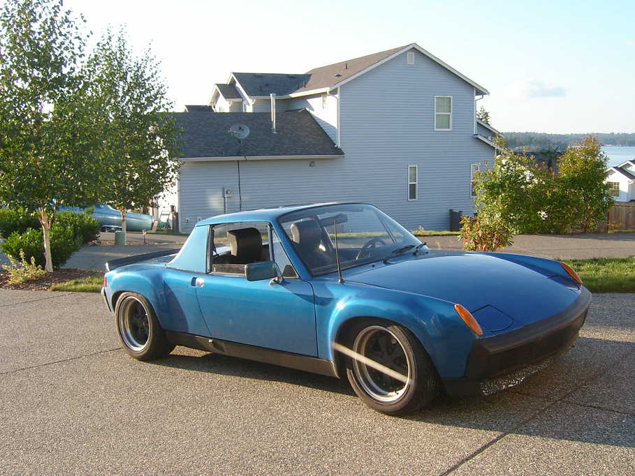

This is not a project for any sort of beginer or not anything I would recomend for anyone who cannot do it all themselves. I spent waaaaay too many hours to justify having an actual shop try it. I also probably wouldn't ever do this again for fear that I wouldn't be able to reproduce the same results. Yeah, it turned out that good. That said, as I post pictures, understand this project is already DONE. So it WORKS and looks as though the factory installed every piece. So sit back, enjoy and maybe dream that you might one day yourself embark on such a task. Hopefully this will help those few people who dare to be as stupid as I. (IMG:style_emoticons/default/screwy.gif)

Like I mentioned before, the whole car needs to be painted as a whole, but here is more of the "finished" product.

Root_Werks   Like I mentioned before, the whole car needs to be...   Sep 23 2007, 08:14 PM
Root_Werks   The setting sun was messing with my picture taking...   Sep 23 2007, 08:17 PM
Root_Werks   Sunroof open.   Sep 23 2007, 08:54 PM
Root_Werks   Too much sunshine! :D Last one.   Sep 23 2007, 08:58 PM
