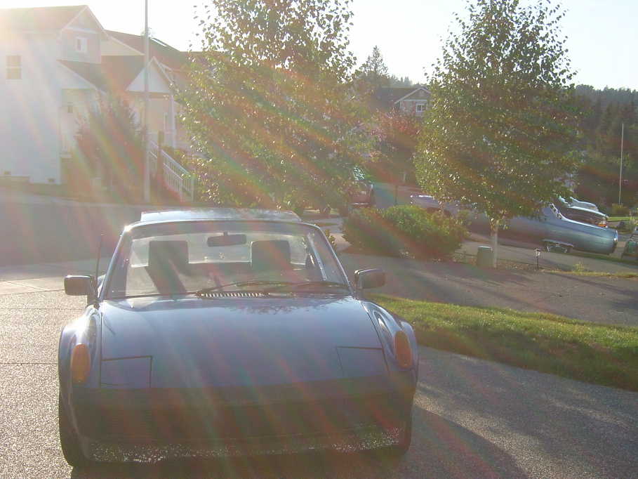

Too much sunshine! (IMG:style_emoticons/default/biggrin.gif) Last one.

Root_Werks   Like I mentioned before, the whole car needs to be...   Sep 23 2007, 08:14 PM
Root_Werks   The setting sun was messing with my picture taking...   Sep 23 2007, 08:17 PM
Root_Werks   Sunroof open.   Sep 23 2007, 08:54 PM
Root_Werks   Too much sunshine! :D Last one.   Sep 23 2007, 08:58 PM
