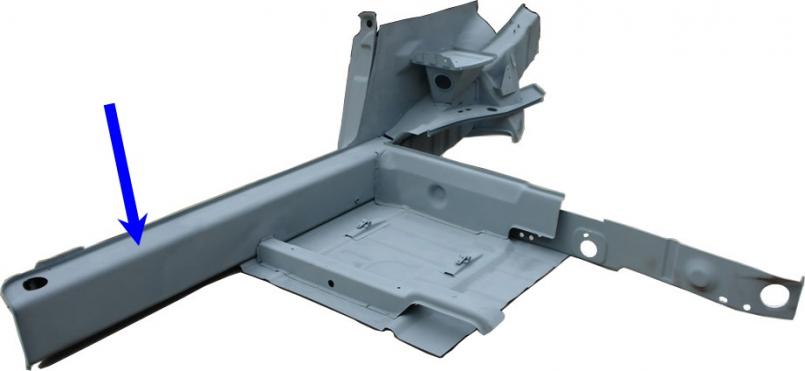

Back to the problem at hand, I am concerned about getting the car in the air and taking of the outer rocker as with the inner so bad it is the only thing holding it together on that side. Is the arrowed item the inner part of the clambshell?

thomasotten   I would keep your eyes out for a good "rust f...   Sep 23 2007, 05:34 PM
my928s4   I would keep your eyes out for a good "rust ...   Sep 23 2007, 05:46 PM
Pat Garvey   I would keep your eyes out for a good "rust ...   Sep 23 2007, 08:13 PM

echocanyons   That crack is a flex crack in the longs, I never n...   Sep 23 2007, 09:01 PM
my928s4   That crack is a flex crack in the longs, I never ...   Sep 23 2007, 09:11 PM
