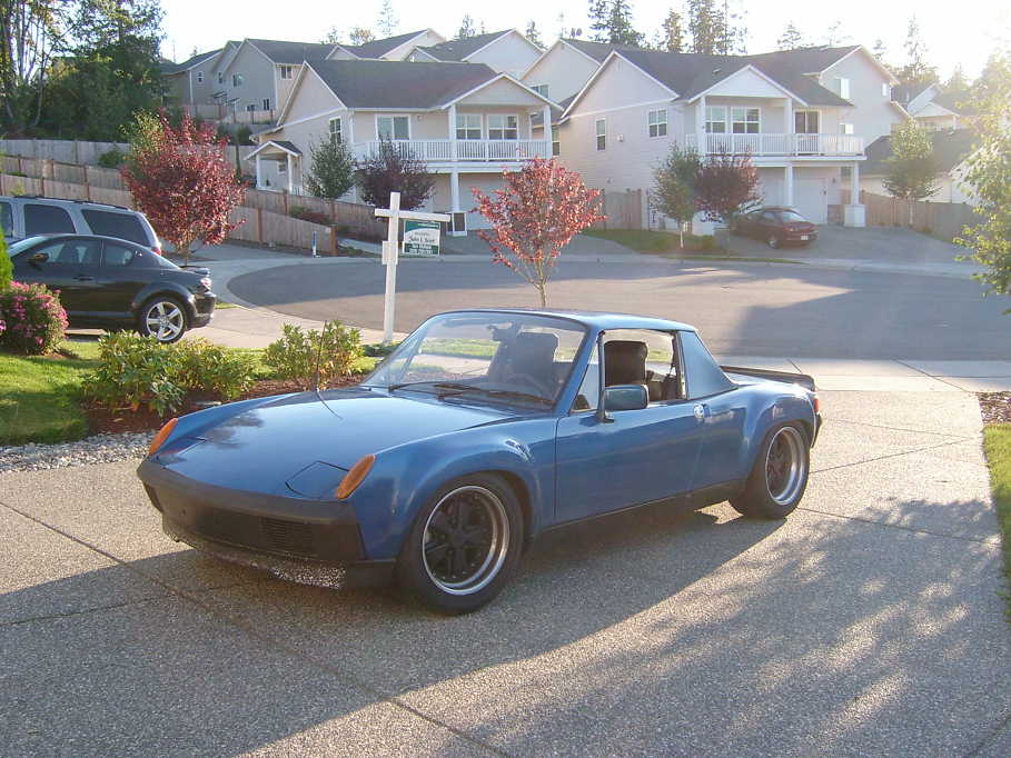

Root_Werks   Like I mentioned before, the whole car needs to be...   Sep 23 2007, 08:14 PM
Root_Werks   The setting sun was messing with my picture taking...   Sep 23 2007, 08:17 PM
Root_Werks   Sunroof open.   Sep 23 2007, 08:54 PM
Root_Werks   Too much sunshine! :D Last one.   Sep 23 2007, 08:58 PM

Dan (Almaden Valley)   nice job Dan....looks totally factory original...I...   Sep 23 2007, 10:14 PM
effutuo101   and you worked in a picture of the new crib! N...   Sep 23 2007, 10:46 PM
Blood red 914-6gt   Wow Dan That looks really amazing. The next time ...   Sep 24 2007, 01:07 AM
BahnBrenner914   That's definately going on my all-out-crazy-I-...   Sep 24 2007, 12:45 PM
effutuo101   Ok, so there i am on the freeway when I see Dan Ro...   Sep 24 2007, 08:00 PM
Root_Werks   Ok, so there i am on the freeway when I see Dan R...   Sep 24 2007, 08:18 PM
effutuo101   Yep, nice day for a ride. I didn't see the fro...   Sep 24 2007, 11:30 PM
