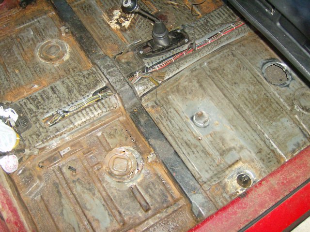

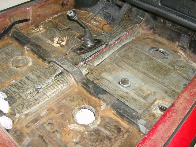

have any of ya'll completely removed the rat's nest of wires that go under the passenger seat?? seems like since it's not even functioning, that it could be removed..
Things I dont know:
1. what is the round connector for thats in the center tunnel wiring harness as showin in the pic?
2. What is that little rotating "knob" next to the heater control lever for on right in front of the shifter?
3. what is that one lone black wire with female spade for thats running along the center tunnel as seen in the pic?
4. any ingenious ideas to make a really thin shop vac attachment to clean down under the center tunnel nooks and crannies? i folded a paper plate into a funnel shape and it kinda worked...
