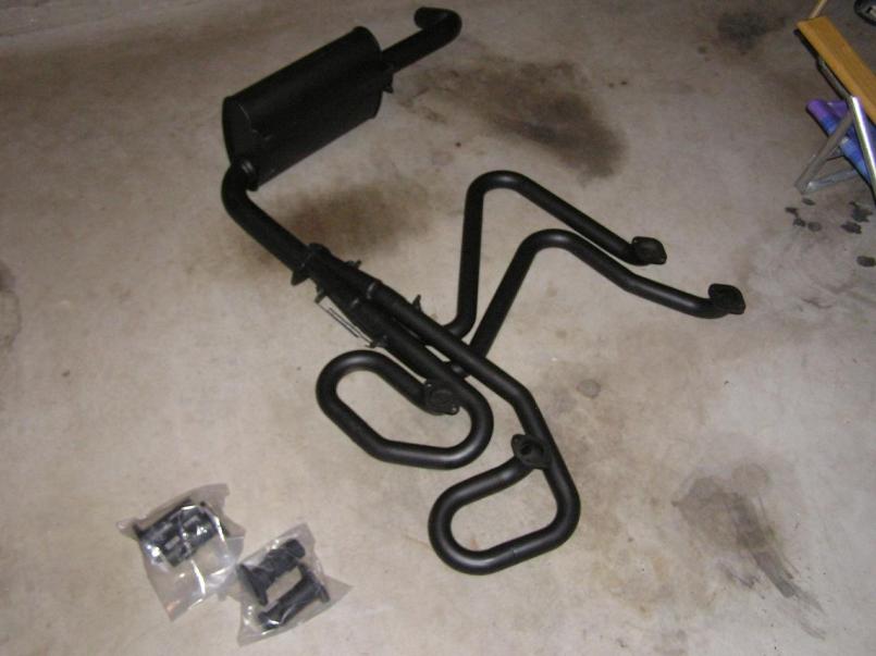

I only started it up a couple times, i didnt let it run for more than 20 seconds.
But look what just showed up today... HAHAHAHAH!!!
