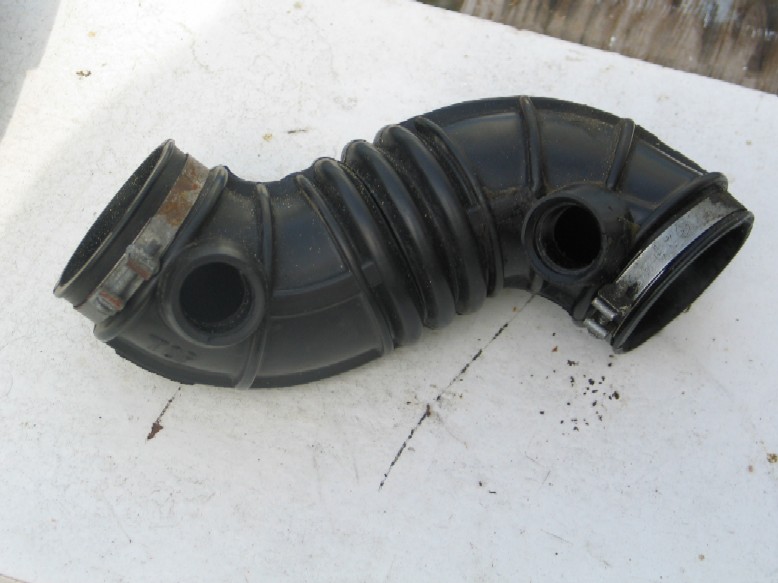

Anyone tried to repair rips in their boots? Most of mine seem solid minus the rips. I was thinking some bike tire cement or maybe shoe goo? Seriously, I am not in the mood to spend another $50 bucks for boots. These aren't too bad...just need a little TLC. All input is appreciated.

I have succesfully repaired the boot using a Wet Suit reair kit sold at dive shops. This stuff really holds up. I last did mine 4 years ago and just inspected it Saturday. Also used it to repair a tear in my swim fins--these get a lot os use and the rubber is pretty old--they are 100% bonded back together.
