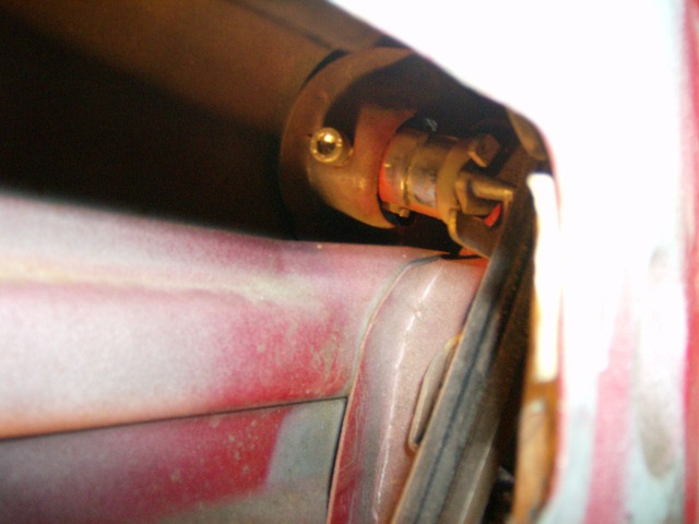

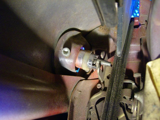

trying to figure out why the passenger door handle wont open it from the outside, but it will from the inside...
i dont really know how the mechanism functions so i dont know if something is missing or broken? doesn't feel like theres ANY resistance on the outer handle at all whereas the driver's door does...
i took some pics.. maybe you can spot something that is broken or missing?
also.. haynes manual is kinda confusing on it's removal.. what's involved?
with handle pulled:

Cevan   It's probably the door latch cam, circled belo...   Oct 10 2007, 07:35 PM
