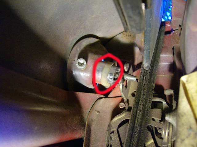

It's probably the door latch cam, circled below. When you pull the exterior door handle, it pushes this plastic piece against part of the door lock mechanism. A part of it breaks off and no longer activates the mechanism.
Auto Atlanta sells a replacement one that's allegedly made of stonger plastic. I've purchased and installed one before. You can get it here.
It looks like your door panel is already removed. To remove the exterior door handle, there is the 5mm allen bolt in your photo and another nut on the interior part of the door. It comes right out. There is a couple of rubber gaskets, one behind the nut and a curved one near the allen bolt.
Just be careful removing the old piece and installing the new one. The part of the door handle that contacts this cam is brittle.

stateofidleness   Update: trying to figure out why the passenger do...   Oct 10 2007, 06:47 PM
