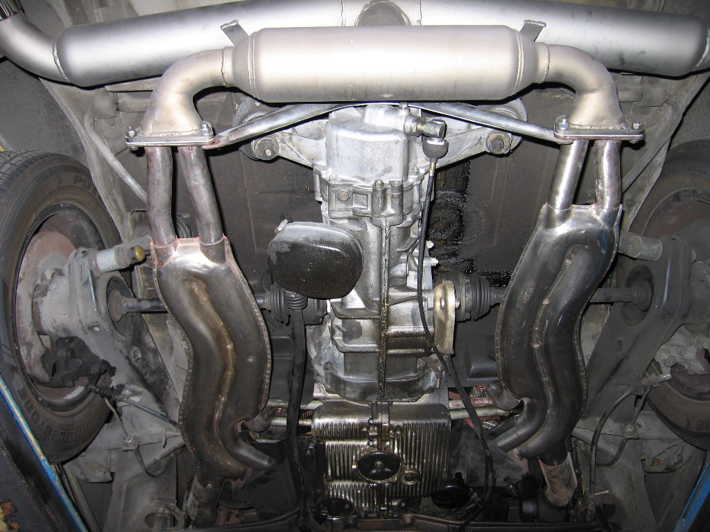

Here're a couple pics. See anything interesting/disturbing? Let me know. (IMG:style_emoticons/default/biggrin.gif)

Lavanaut   Another. First time I've had my car on a lift...   Oct 12 2007, 03:46 PM
Lavanaut   Last one   Oct 12 2007, 03:47 PM

Lavanaut   Went and picked up the car today. Check out the p...   Jun 5 2008, 01:50 PM
SirAndy   This was obviously not a split at the seam formed...   Jun 5 2008, 02:19 PM
