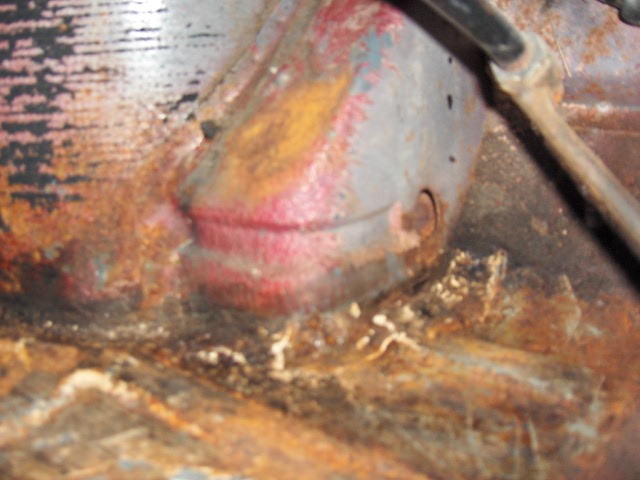

type47   is it rusted through, that is, do you see the road...   Sep 23 2007, 02:18 PM
stateofidleness   Now I've pretty much read EVERY thread in the ...   Sep 23 2007, 02:21 PM
stateofidleness   Type, it is rusted through in SOME spots but not a...   Sep 23 2007, 02:25 PM
Blood red 914-6gt   I have a new rear pan with the stiffeners that I t...   Sep 23 2007, 02:57 PM
Bartlett 914   That all looks repairable. I would look over the l...   Sep 23 2007, 03:02 PM
Chuck   Don't worry. You can do this. At least your se...   Sep 23 2007, 03:39 PM

swl   heck - that ain't rust! You're good t...   Sep 23 2007, 07:26 PM
stateofidleness   under the seats? or near the pedals?   Sep 23 2007, 07:27 PM

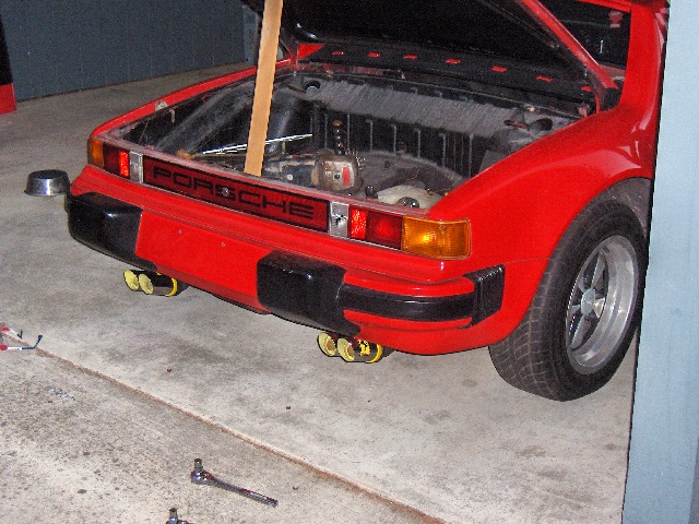

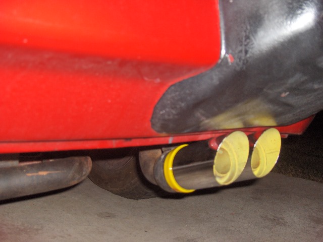

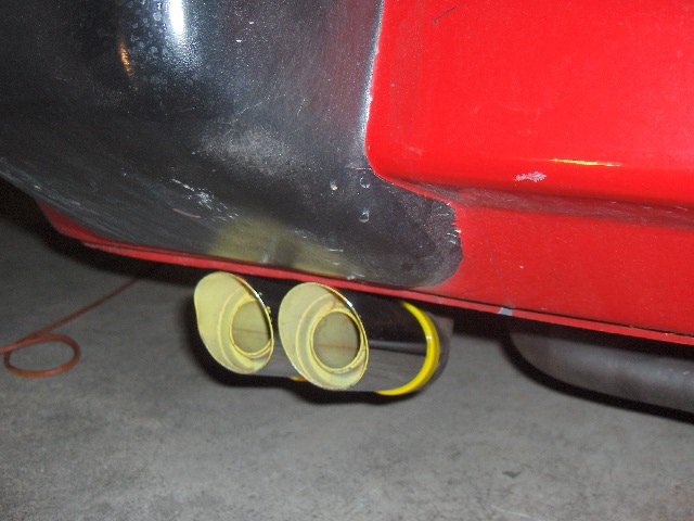

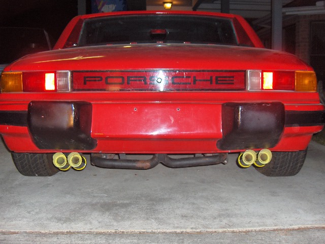

stateofidleness   "Progress" test fitted the new exhaust ...   Oct 12 2007, 08:07 PM

Tom   Maybe a good muffler shop could cut the tips off a...   Oct 12 2007, 11:54 PM
angerosa   Yeah - Isn't the tailpipe clearence "not ...   Oct 13 2007, 08:08 PM
