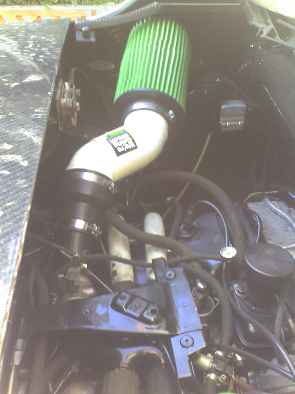

I built this below for my 1.7....GREEN racing filter from Summit on Clearance (for a 5L V8!!), magic 2.5" 45 deg male/female ABS to connect to throttle body, and other plumbing. Total cost was roughly $60 + 1 hr labor + 2 hours shopping.
I was going for cold-air intake as well as increased flow at high rpms. I race AX a lot and have a nice header, so I didn't want flow restricted at the intake. I still need to plumb the oil overflow, which used to be outside the filter/oil bath into a oil breather box. This type of set-up is louder than stock (like carb intake noise) and I think it does help 4-6K rpm. (IMG:style_emoticons/default/beerchug.gif)
