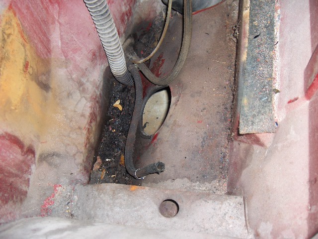

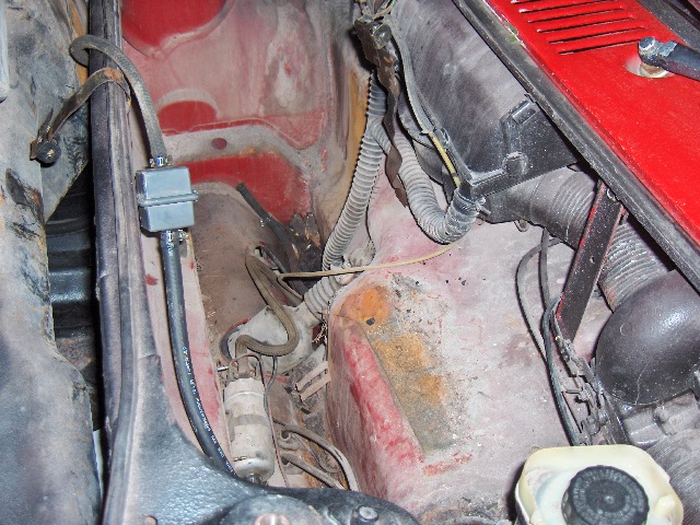

you might have heard of my recent personal setbacks... but after finally getting to drive the car yesterday and knowing what im missing out on by it just sitting in the garage.. im full steam ahead again!
i broke one of my rules and got unfocused and turned my attention to the gas tank for some reason... so here's some pics of the removal... i guess one of those things you learn the first go round is to remove the gas first huh (IMG:style_emoticons/default/wink.gif)
looks pretty clean except for that "shelf" area with the debris on it.. and the only reason it looks wet in the pic is from the gas that leaked
