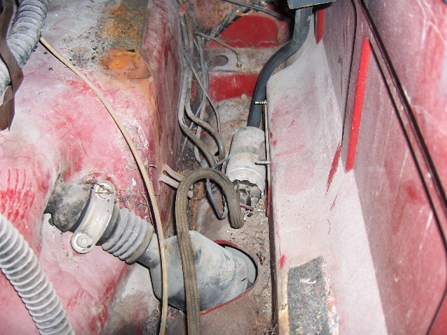

stateofidleness   ok so today i really started tryin to get the fact...   Sep 26 2007, 05:11 PM
stateofidleness   it actually looks patchable right now. how do i t...   Sep 26 2007, 05:24 PM
SirAndy   do a search here. McMark posted some good pics of ...   Sep 26 2007, 05:31 PM

McMark   Lots more cleaning to do. Grab some rust converte...   Sep 26 2007, 06:49 PM
stateofidleness   i was wondering about that.. the order of events i...   Sep 26 2007, 07:21 PM
McMark   Rust converters such as POR-15 MetalReady can be u...   Sep 26 2007, 07:31 PM
