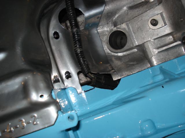

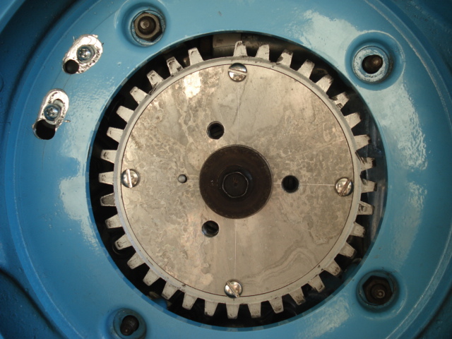

made some more progress on the engine bay. The engine build has come to a screeching halt.
Here are some pics
made an adapter plate for the 36-1 wheel, and modified the fan housing for the VR sensor. I will take more pics of how the adapter plate and the trigger wheel where modified for Brer's MS file.
The second pic is the VR sensor plug and wire with the mods made to the tin and housing to accept it.
