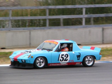

I was late for a meeting when I posted this. Here's some more info.
The brake coolers work very well. They even work better when you run the tubing to the front air dam. See vents in pic
I actually have a fiberglas version of the coolers from OGRacing that has 3" tubing v.s. the 2.5" tubing on the AJ kit. OGRacing lists replacement tubing that mentions their "cool brake kit", but I couldn't find the Cool Brake kit itself? You probably need to contact them if you are interested. When I ordered mine, I got the whole story of 3" tubing flow v.s. 2.5" and also that their kit was a copy of the Al Holbert racing coolers.. I'm very happy with the OGRacing kit. But to be honest, the 2.5 tubing is easier to route. I have some clearance "challenges" with the 3" tubing but it is workable.
