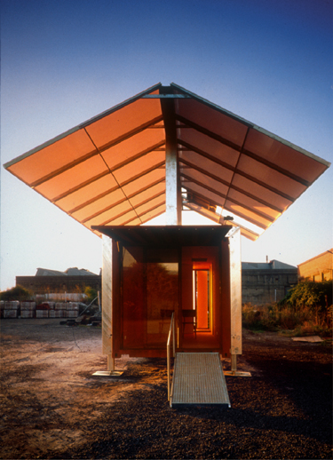

oh, i almost forgot. You could build a Parasol roof system to shade your existing structure.
