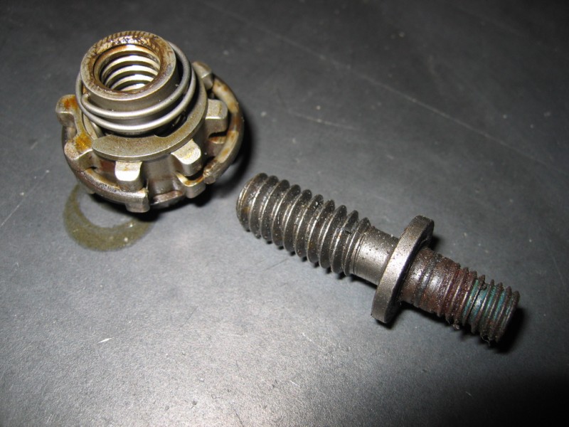

Here's one that was on the bench. The assembly is probably spinning inside that snap ring. You need to work the threads back and forth on that adjuster so it will screw in all the way and pull in the piston.
C-Clamp will be difficult on the caliper face. The adjuster on the outer piston is smack dab in the middle. Anything offset from that and the clamp will want to slide off the face. If it doesn't work it's way in with hand pressure it may not work at all... worth a try though.
Good luck with it.

Eric_Shea   Here's one that was on the bench. The assembl...   Dec 12 2007, 09:10 PM

Eric_Shea   Other side... difficult to keep the c-clamp on t...   Dec 12 2007, 09:59 PM
Jeffs9146   I agree! The alternative is to rebuild! ...   Dec 12 2007, 10:35 PM
