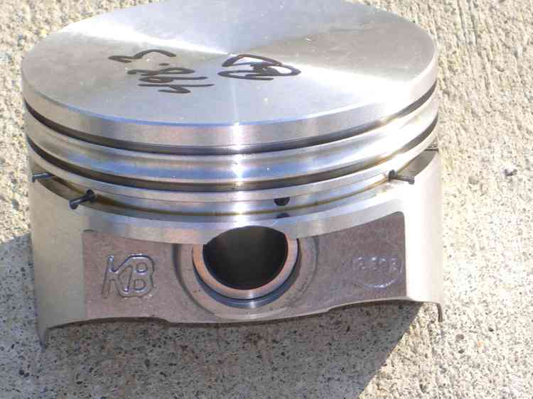

MrKona   And on went the cylinders. It was easy to install ...   Jun 1 2008, 01:54 AM
MrKona   Pistons/Cylinders...   Jun 1 2008, 01:55 AM

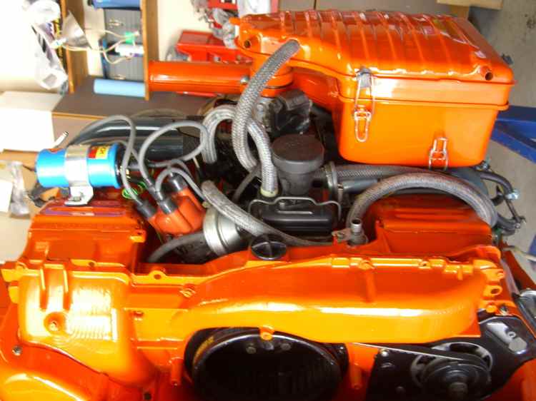

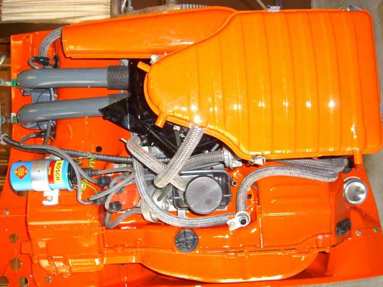

MrKona   An update of the latest status of my engine rebuil...   Apr 18 2010, 10:28 PM
MrKona   A couple more shots of the engine before it goes i...   Apr 18 2010, 10:30 PM
Phoenix914   Your engine is a work of art, my friend. :headbang...   Apr 19 2010, 09:00 AM
