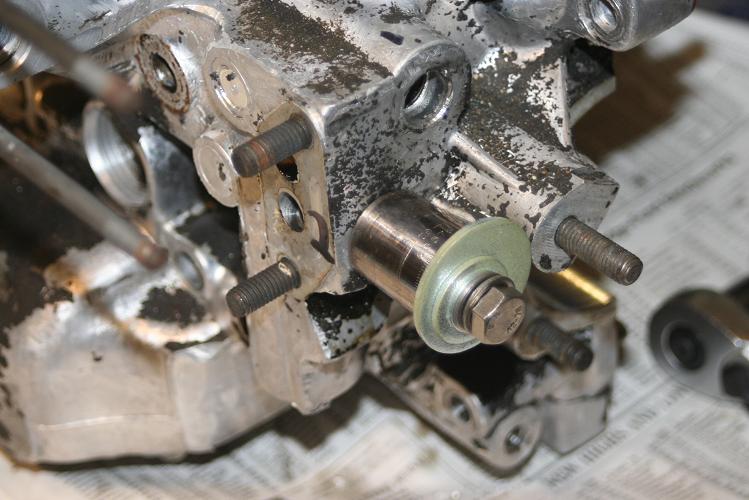

So now for my first question: Regarding the existing cylinder studs, Tom Wilson writes, "Unless you're installing case savers, don't remove the cylinder studs from the case. Doing so has no purpose, but does wear the potentially troublesome case threads, takes time, and stresses the studs" (p. 76).
In the assembly section, he states "If the cylinder studs were removed for some reason, install them now. Apply Permatex 3H to their threads to stop oil leaks" (p. 120).
I don't know the history of this case. I don't know if there was leakage at the head studs. Should I remove the studs, and reinstall with Permatex (after the case comes back from the machine shop, obviously) as a precaution to prevent potential leakage? Or should I just leave them be as is? Does it really put that much stress on the case to remove them, or is Wilson referring primarily to the Type I-III magnesium cases? I am leaning to toward remove and reinstall, as I strongly intend for this engine to be leak-free.

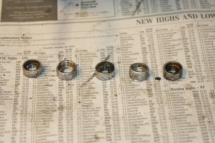

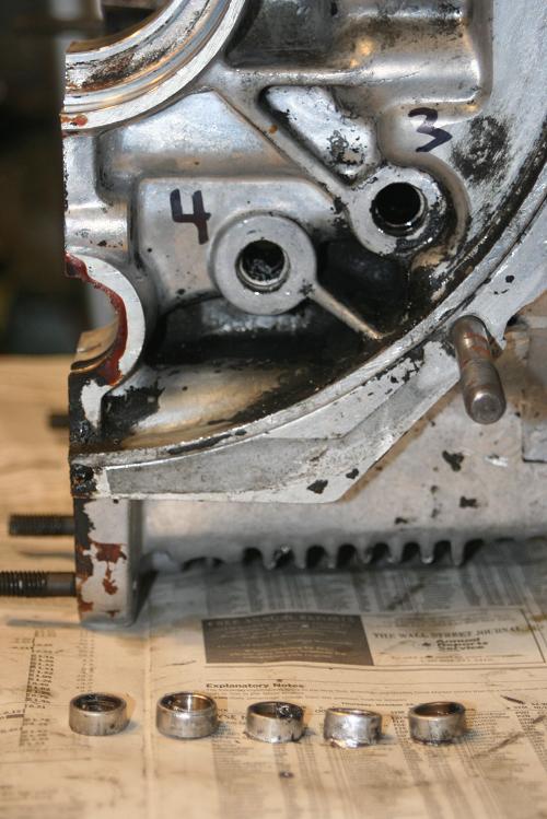

I took the case to the local self-serve car wash to clean it up enough to work on it. This afternoon, I removed the recommended five factory galley plugs. They came out quite easily. Pretty scary to think of not changing these out! Next, off to the machine shop!
