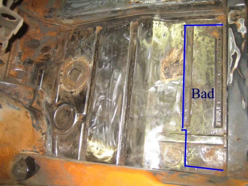

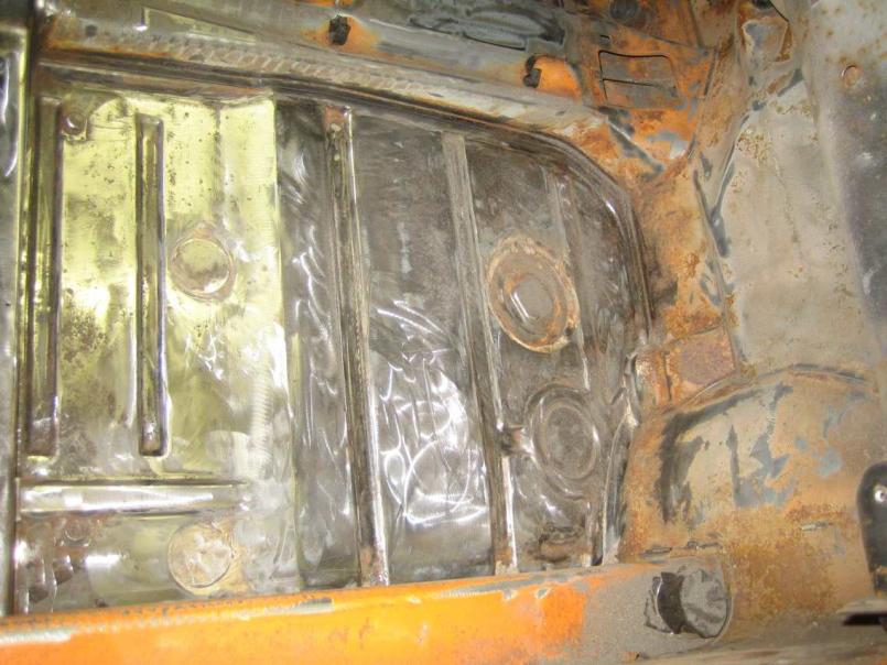

The bad
The good

my928s4   OK got a couple of hours in yesterday and today wi...   Dec 30 2007, 02:30 PM
my928s4   The bad The good   Dec 30 2007, 02:35 PM
my928s4   Messed up.   Dec 30 2007, 02:37 PM
scotty b   rear pan section is definitely needed. IMHO that s...   Dec 30 2007, 05:18 PM
