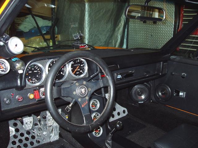

I have a shift light in my street driven car because when the boost kicks in, red line comes up fast, with my short geared tranny I have my hands full and my eyes need to be looking straight ahead. (IMG:style_emoticons/default/driving.gif)
Simple installation, tie into the tach wire, switched power and ground. Mine uses pills
set at different RPM's to adjust.
