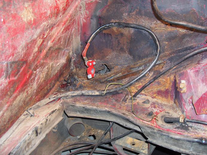

type47   is it rusted through, that is, do you see the road...   Sep 23 2007, 02:18 PM
stateofidleness   Now I've pretty much read EVERY thread in the ...   Sep 23 2007, 02:21 PM
stateofidleness   Type, it is rusted through in SOME spots but not a...   Sep 23 2007, 02:25 PM

Bartlett 914   That all looks repairable. I would look over the l...   Sep 23 2007, 03:02 PM

Bartlett 914   You have a couple of holes to patch up. Not too ba...   Sep 24 2007, 08:06 AM

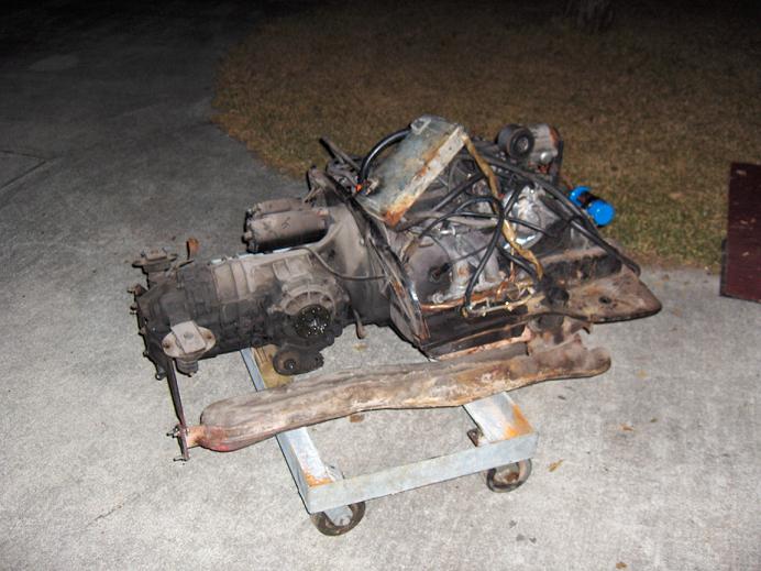

stateofidleness   well... SHES OUT!!!! im so proud...   Jan 3 2008, 08:20 PM

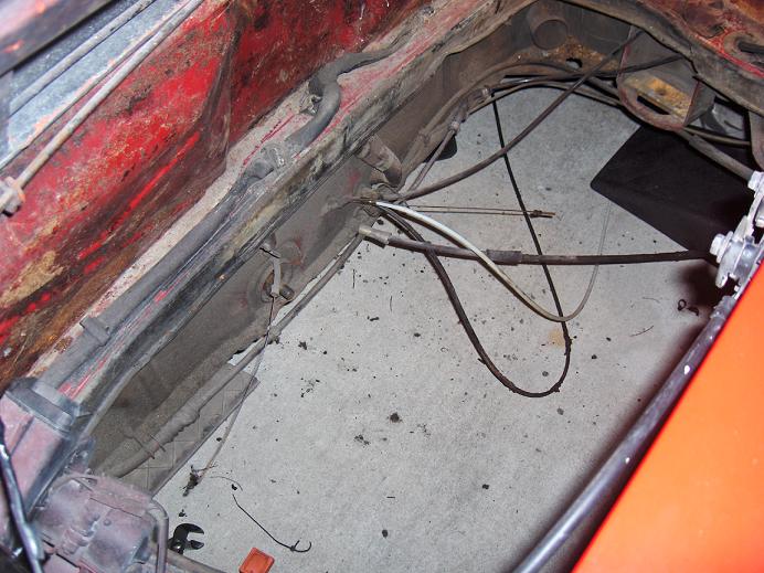

stateofidleness   the heater flapper boxes cables dont connect to an...   Jan 3 2008, 08:26 PM

stateofidleness   sommmeee progress... finally got the engine out an...   Jan 9 2008, 09:56 PM

914Sixer   Send me your phone number and I will make arrangem...   Jan 10 2008, 02:01 PM
CMONNETT   You can take all the emissions stuff off, as long ...   Jan 10 2008, 02:39 PM
