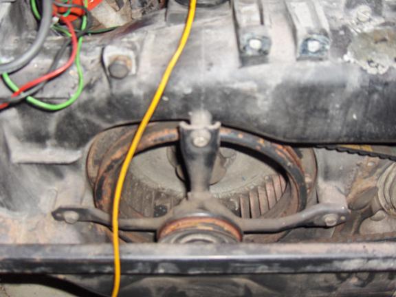

CAN I REMOVE THIS BRACKET THAT SUPPORTED THE SMOG AIR PUMP?
IS THIS SUPPOSED TO BE MOUNTED HERE? LOOKS LIKE ONE OF THE CORNERS IS JUST HANGING AND SHOULD BE SCREWED DOWN BUT THERES NO HOLE FOR ONE

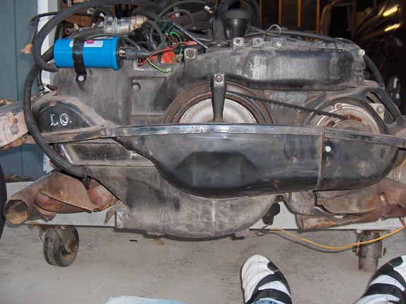

HERES A PIC OF THE ENGINE STAMP(FOR THAT OTHER THREAD).. WHAT IM WONDERING IS IF I REMOVE THE HEATING SYSTEM, HOW I "PLUG" THE HOLES WHERE THE (i think) "j" TUBES CONNECT TO THE FAN SHROUD?

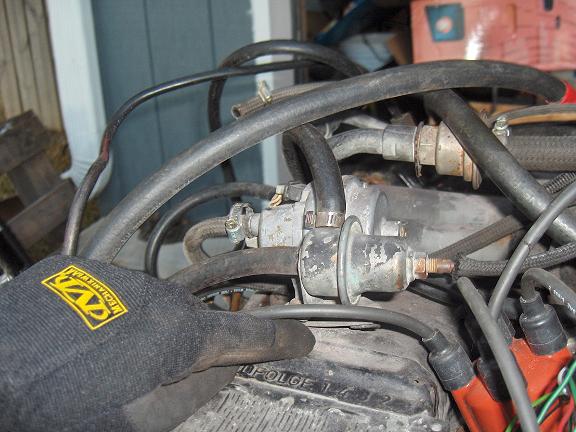

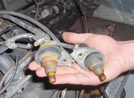

HOW DO THE INJECTORS LOOK?

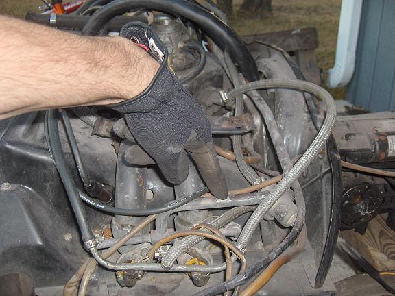

WHERE MY FINGER IS TOUCHING IN THE PIC, IS THAT METAL "RAIL" NEEDED? WHAT IS IT AND WHAT DOES IT DO? IS IT PART OF THE SMOG STUFF?
These are just a few of the 100's of questions i have lol... I really am wanting to rid the engine completely of the added SMOG equipment before i start fixing and replacing things.. does anyone have a list of all smog-added equipment or can they point stuff out if i post pics of the engine? i just want it as "clean" and "minimal" as possible

CMONNETT   You can take all the emissions stuff off, as long ...   Jan 10 2008, 02:39 PM

stateofidleness   so i took this "bracket" looking thing o...   Jan 21 2008, 08:12 PM
jd74914   It holds the air cleaner.   Jan 21 2008, 09:37 PM
