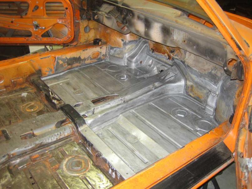

my928s4   OK so still waiting for the floor panel so I decid...   Feb 3 2008, 09:08 PM
my928s4   OK so still waiting for the floor panel so I decid...   Feb 3 2008, 09:09 PM
my928s4   Here are the two holes after grinding.   Feb 3 2008, 09:13 PM

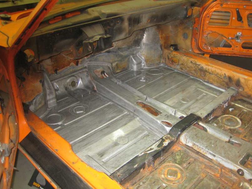

my928s4   OK now onto the BIG job of the day, the floor pan ...   Feb 9 2008, 04:53 PM
my928s4   Got the wire wheel attachment on the grinder and d...   Feb 10 2008, 04:44 PM

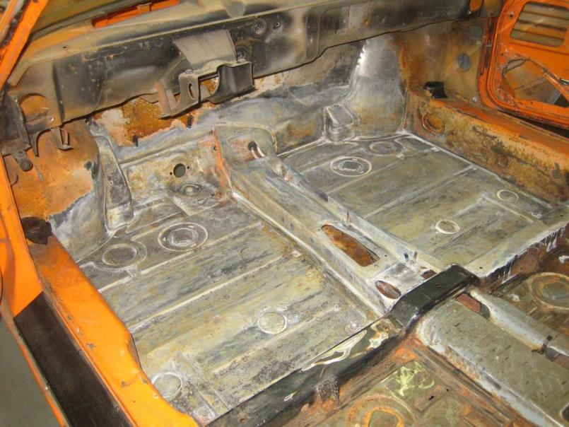

my928s4   Another weekend lying mainly under the car, I thou...   Feb 17 2008, 09:22 PM
my928s4   I ordered some seat mount hinges from restoration ...   Feb 17 2008, 09:25 PM
jim912928   Excellent progress!   Feb 17 2008, 10:24 PM
my928s4   OK, spent some serious time on the car yesterday a...   Feb 24 2008, 06:39 PM
