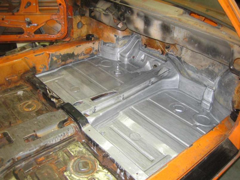

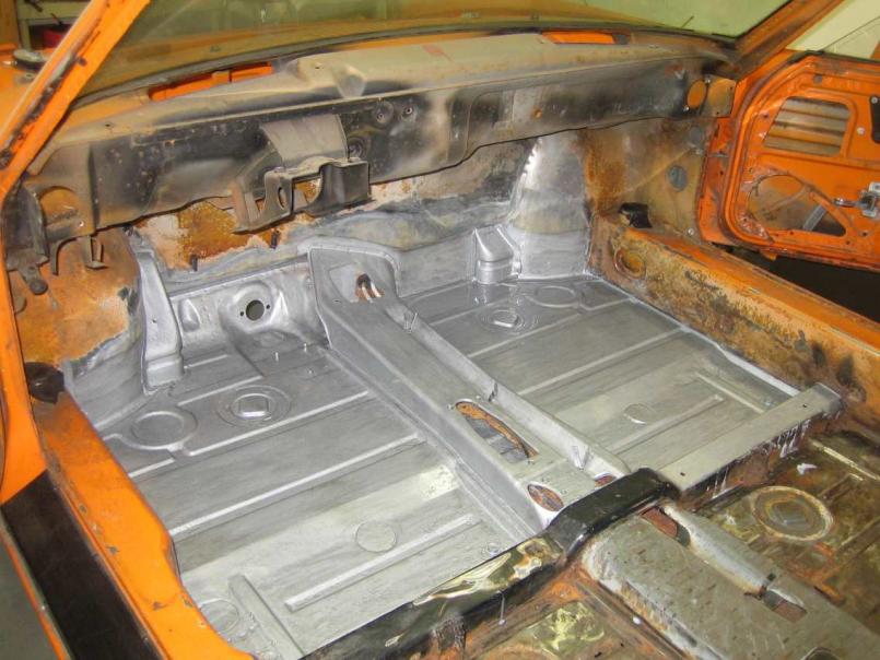

And then a 2nd coat, looked pretty good so I will finish of the interior with this followed by primer and color later.
