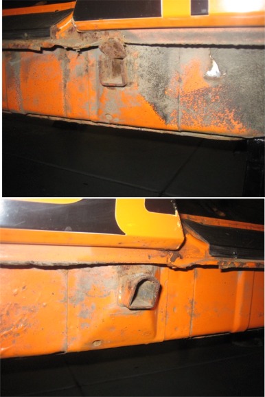

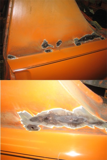

OK, couple of questions.
What should I do with the driver side jack post? This area looks to be lacking in rust but metal fatigue seems to be an issue, any suggestions? I searched the archives and there did not seem to be an easy way to gain access to the upper portion of the jack post to remove. Maybe I am missing something obvious.
Drivers side sail panel, no doubt this looks a lot worse underneath, do I need to replace the whole part of just cut out the bit that needs replacing?

my928s4   OK got a couple of hours in yesterday and today wi...   Dec 30 2007, 02:30 PM
my928s4   The bad The good   Dec 30 2007, 02:35 PM
my928s4   Messed up.   Dec 30 2007, 02:37 PM
scotty b   rear pan section is definitely needed. IMHO that s...   Dec 30 2007, 05:18 PM
my928s4   B)-->
QUOTE(scotty b @ D...   Dec 30 2007, 07:13 PM
my928s4   B)-->
QUOTE(scotty b @ D...   Dec 30 2007, 09:17 PM
McMark   I would section in the rear pan, not do a complete...   Dec 30 2007, 10:59 PM

scotty b   IMO the jack post should ALWAYS be cut out as they...   Jan 13 2008, 06:48 PM
my928s4   B)-->
QUOTE(scotty b @ J...   Jan 14 2008, 08:36 AM
finstermojo   When i did my resto and did the same thing you are...   Jan 13 2008, 08:12 PM
my928s4   When i did my resto and did the same thing you ar...   Jan 14 2008, 08:40 AM
