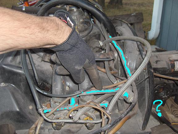

hey chris not to sound dumb, but where are the air injectors? got a pic?
and i still dont know what this part is and if it can be removed or not?
did some wire brushing and gettin it all cleaned up pretty nice
got the new trans mounts on and ready to tackle the intake runners...
the smog stuff still has me baffled.. surely there's someone that has done a smog removal before and can list what all can be removed? (IMG:style_emoticons/default/smile.gif)

CMONNETT   You can take all the emissions stuff off, as long ...   Jan 10 2008, 02:39 PM
stateofidleness   hey chris not to sound dumb, but where are the air...   Jan 20 2008, 07:10 PM
stateofidleness   so i took this "bracket" looking thing o...   Jan 21 2008, 08:12 PM
jd74914   It holds the air cleaner.   Jan 21 2008, 09:37 PM
stateofidleness   ahh ok. thank you sir. new question: what all do ...   Jan 21 2008, 09:52 PM
CMONNETT   The air injectors are the small tubes coming out o...   Jan 21 2008, 10:00 PM
