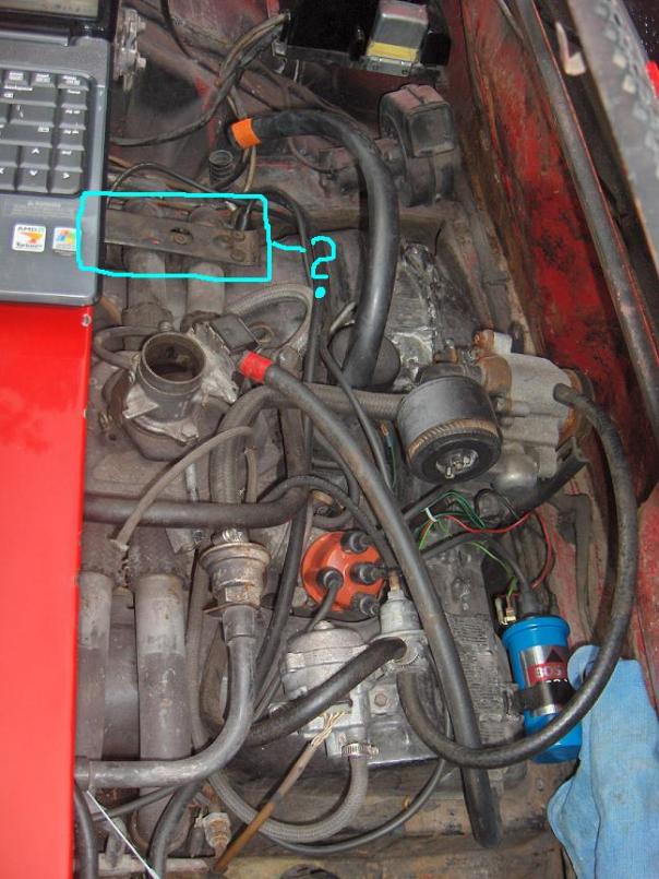

so i took this "bracket" looking thing off tonight when looking for stuff to prep for paint and not even sure what it's use is... what is it and can it be removed?

stateofidleness   so i took this "bracket" looking thing o...   Jan 21 2008, 08:12 PM
jd74914   It holds the air cleaner.   Jan 21 2008, 09:37 PM
stateofidleness   ahh ok. thank you sir. new question: what all do ...   Jan 21 2008, 09:52 PM
CMONNETT   The air injectors are the small tubes coming out o...   Jan 21 2008, 10:00 PM
