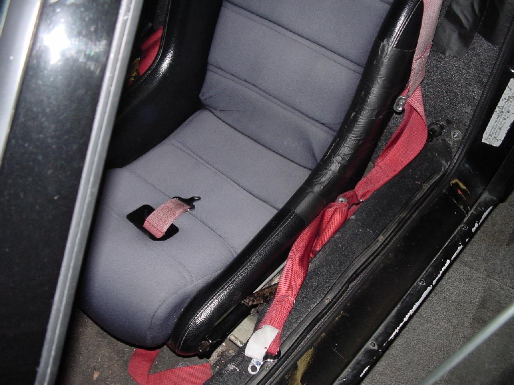

Those intersted in the Corbeau Classic II's should be aware that you can order them with a sub strap hole from the factory. Oh yeah, as a daily driver, the vinyl does not hold up (see the gaffer's tape below) and the color fades pretty quickly, plus the foam in the lumbar region compresses pretty quickly. Once the foam compresses, you can feel a crossbar at the rear that hits me right in the coccyx. Also the seat rails need to be filed out to fit larger bolts that are offset slightly from the stock locations.Attached Image
