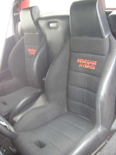

I've got the Renegades, built from 914 cores. They have submarine holes, but I don't know if they would be legal, because the seat shell is just cut for the hole in the cushion?
I had a forza in my car long enough to get rid of it. Its probably good for a track only car, but it was too tight and too hard to get in and out of for me. Not much on comfort either. The Renegades are hard enough to get in and out of.
