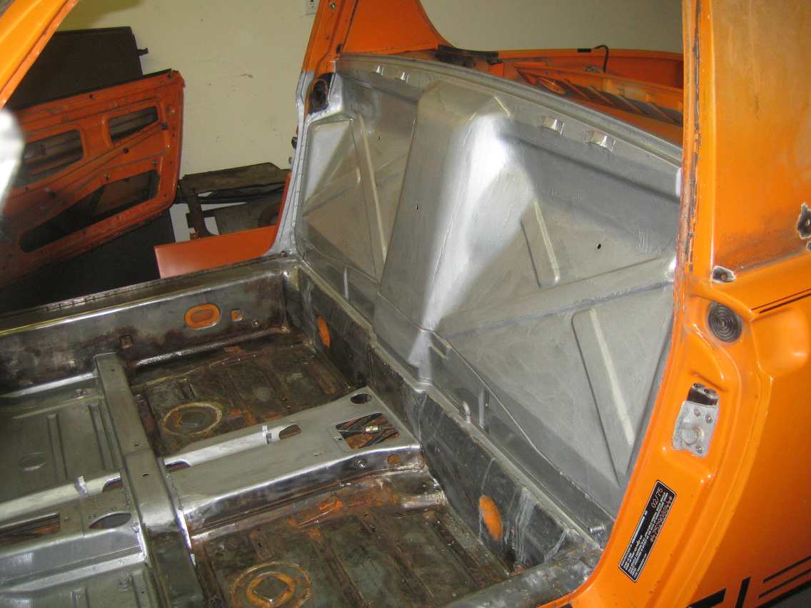

Still waiting for the rear pan (should be here next week) so worked on removing the rest of the paint from the rear bulkhead and then prepping and painting. I left where the Engman kit will go unpainted and I need to get some weld thru primer on those surfaces.

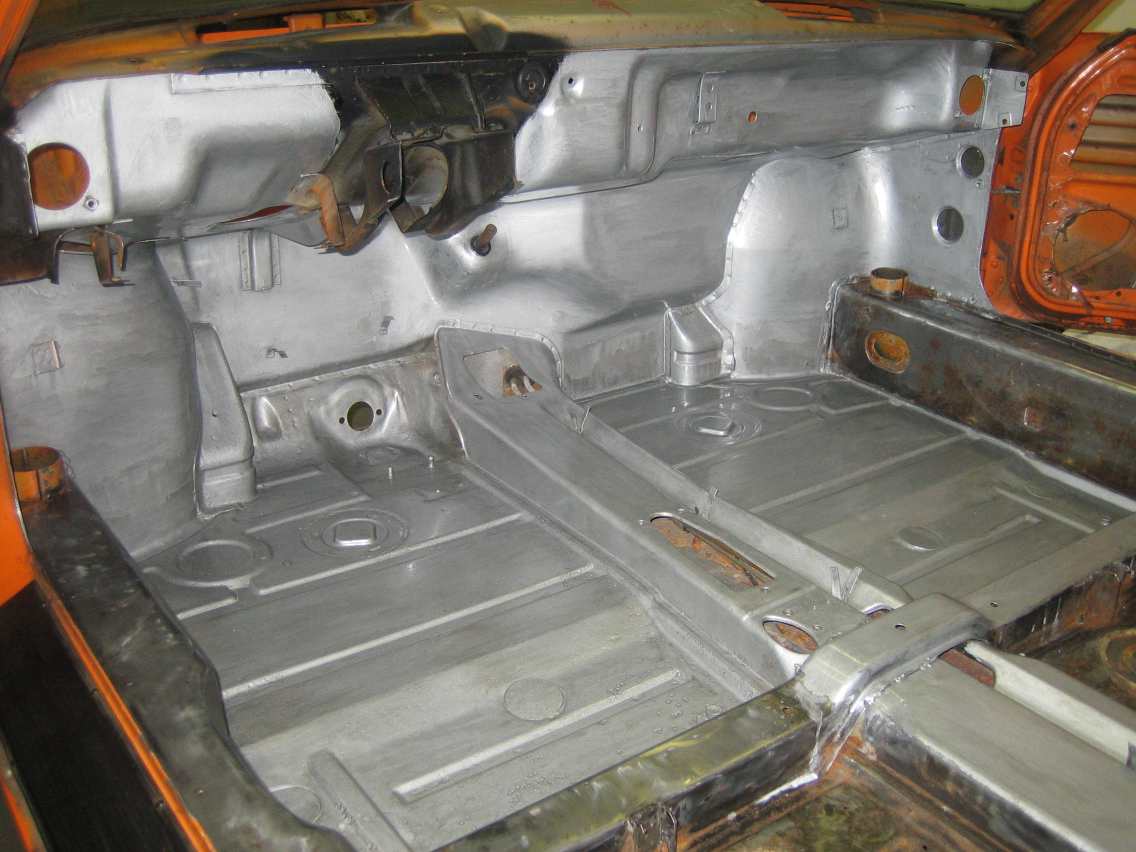

my928s4   OK got a couple of hours in yesterday and today wi...   Dec 30 2007, 02:30 PM
my928s4   The bad The good   Dec 30 2007, 02:35 PM
my928s4   Messed up.   Dec 30 2007, 02:37 PM
scotty b   rear pan section is definitely needed. IMHO that s...   Dec 30 2007, 05:18 PM
my928s4   B)-->
QUOTE(scotty b @ D...   Dec 30 2007, 07:13 PM
my928s4   B)-->
QUOTE(scotty b @ D...   Dec 30 2007, 09:17 PM
McMark   I would section in the rear pan, not do a complete...   Dec 30 2007, 10:59 PM
my928s4   So while making progress with the grinder and wire...   Jan 13 2008, 05:51 PM
my928s4   And then a 2nd coat, looked pretty good so I will ...   Jan 13 2008, 05:55 PM
my928s4   OK, couple of questions. What should I do with th...   Jan 13 2008, 05:59 PM
scotty b   IMO the jack post should ALWAYS be cut out as they...   Jan 13 2008, 06:48 PM

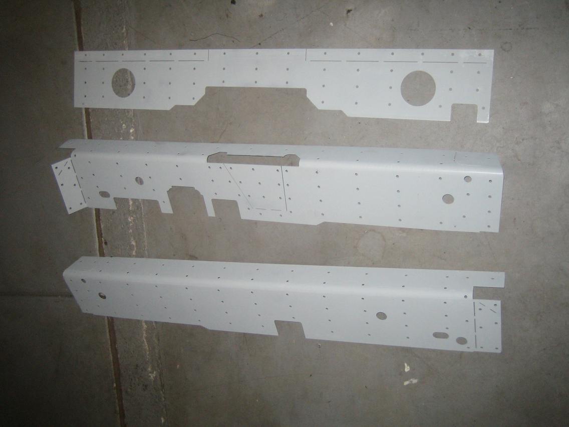

my928s4   After removing the undercoating I printed the temp...   Nov 2 2008, 06:36 PM
