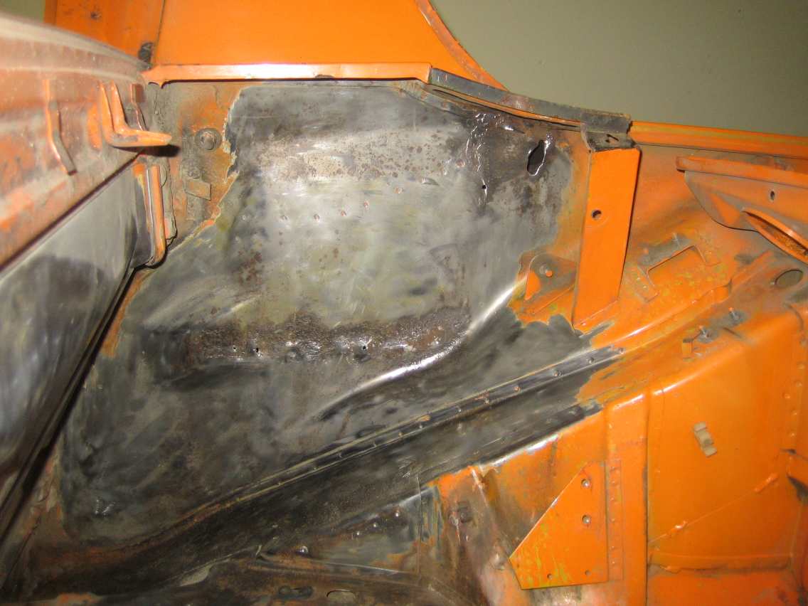

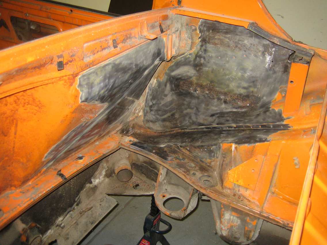

Anyway back to 914 subject matter, the good news is I have not found too many issues which is a relief and I can start to order parts and make some investment in tools. It is a perfect time of year for indoor projects as it is below freezing all the time now and skiing does not start here till after xmas.
Surface rust and dirt in the front trunk but that is about it, will need to repiar a couple of areas around the hood seal.

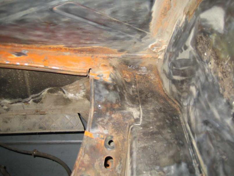

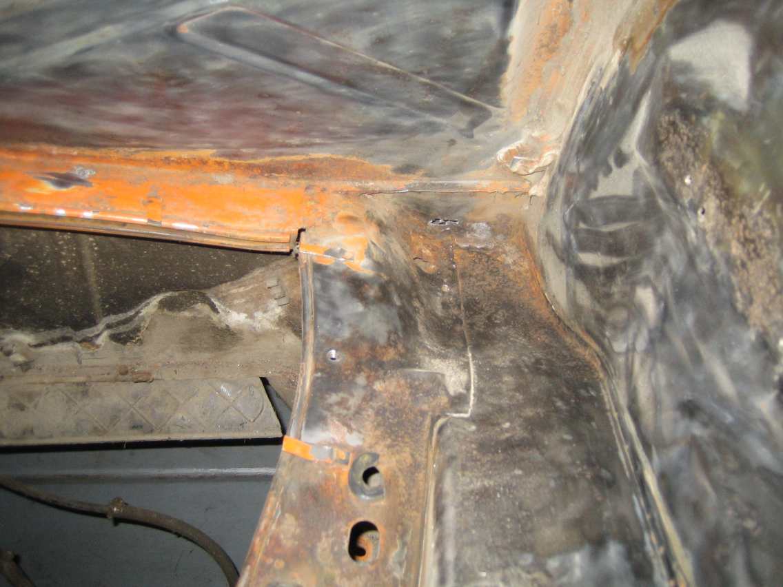

Cleaned up the battery area in the engine bay when I wasn't shovelling snow today. So far I don't see anything to worry about, took some time to remove the amateur trunk pivot that thing had a lot of weld on it.
After the interior this will be the next area that gets attended too.
