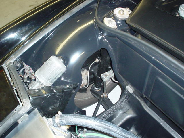

I had similar issues about cutting any part of my car when installing the V8 but overheating was my number one concern with the summer temperatures in my location. Also gave serious thought to using the hole in front trunk floor since my car came with a/c, but my research kept coming up with the Renegade cooling system as being top shelf. So, I found a factory front floor and had it welded back in and went with the installation per RH directions.
There are other advantages to having the wheelwells cut out. You can pull/install front struts easier as well as bleed front brakes from top side of car vs. on your back. I worried about rocks entering the wheelwell opening but this has not happened in the 15 months I've been driving my car.
Considering the exit hole size recommended by RH, I think you would need a much larger duct than you show in the pic if you want to go out the hood. I believe my wheelwell openings are about 12"x15" each.

John2kx   another view   Dec 20 2003, 07:15 AM
