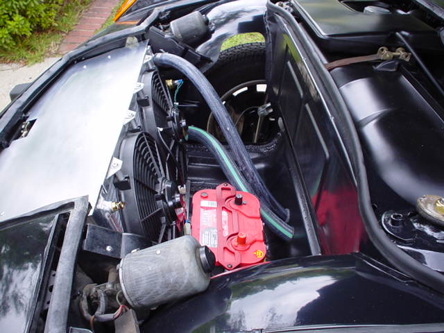

John2kx   I had similar issues about cutting any part of my ...   Dec 20 2003, 07:14 AM
John2kx   another view   Dec 20 2003, 07:15 AM
maf914   John, From your previous posts I know you've ...   Dec 20 2003, 07:23 AM

914Timo   Oh, I wish we could do V8 conversions here too.......   Dec 20 2003, 08:05 AM
Bhuntley   If my memory serves me , Renegade's cooling sy...   Dec 20 2003, 09:54 AM
maf914   Timo, That Optima battery may have a second set o...   Dec 20 2003, 10:05 AM
John2kx   I'll agree, any hole in a sealed front trunk i...   Dec 20 2003, 12:29 PM
