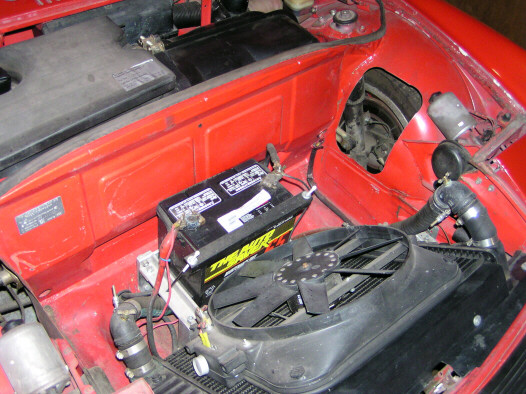

John2kx   I had similar issues about cutting any part of my ...   Dec 20 2003, 07:14 AM
John2kx   another view   Dec 20 2003, 07:15 AM
maf914   John, From your previous posts I know you've ...   Dec 20 2003, 07:23 AM

John2kx   I'll agree, any hole in a sealed front trunk i...   Dec 20 2003, 12:29 PM
