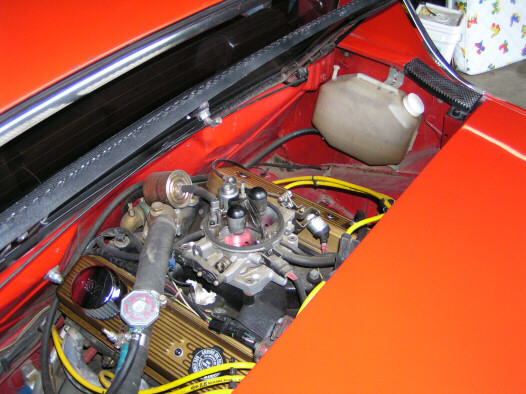

here's the money shot. 302 c.i., later model z/28 heads, holly f.i.

rhodyguy   here's the money shot. 302 c.i., later model z...   Dec 20 2003, 07:45 AM
