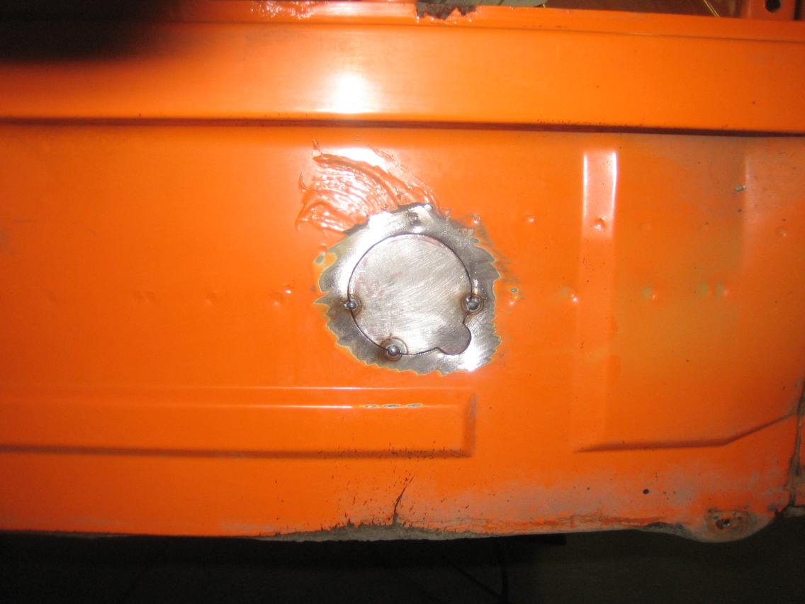

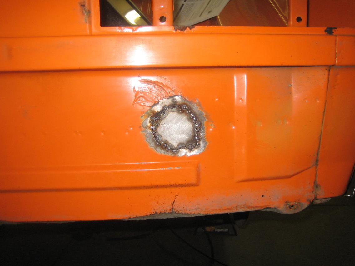

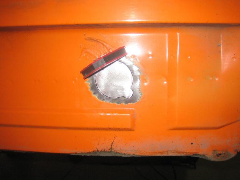

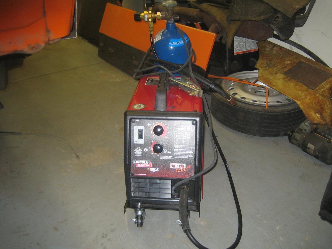

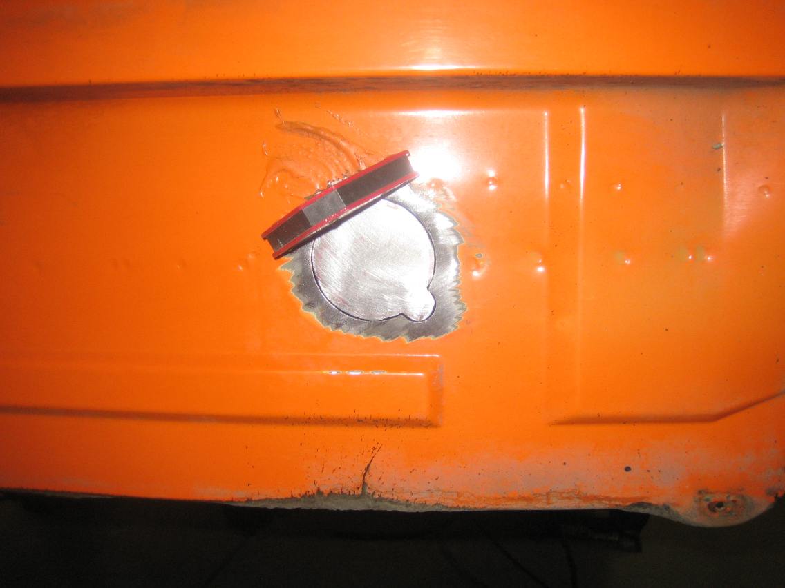

OK so still waiting for the floor panel so I decided that since I bought some gas for my new welder I should put it to good use. Naturally I practiced on scraps for a few hours but could felt that it would be good to try on an area of the car that is well hidden.
So I chose to plug the rear bumper shock holes.
Here is a pic of my welding machine, a Miller was a little rich for my blood and after reading everyone elses experience this seem like s good compromise.
I prepped the area and cut out a patch.
Then tack welded into place.
I was worried about running a bead and heating up the panel too much so I laid multiple tacks. Problem with this is after two or so rounds of tacks I end up with a few tiny pin holes. Is this the right way to do this or should I lay small beads moving around and allowing the panel to cool ??
