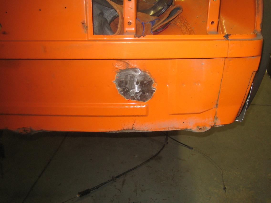

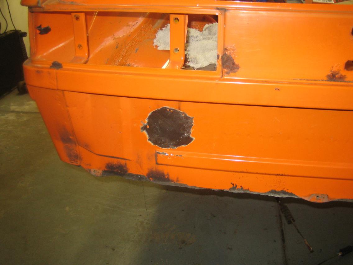

post Feb 3 2008, 09:13 PM
Posts: 349
Joined: 18-August 07
From: Spokane, WA
Member No.: 8,018
Here are the two holes after grinding.
